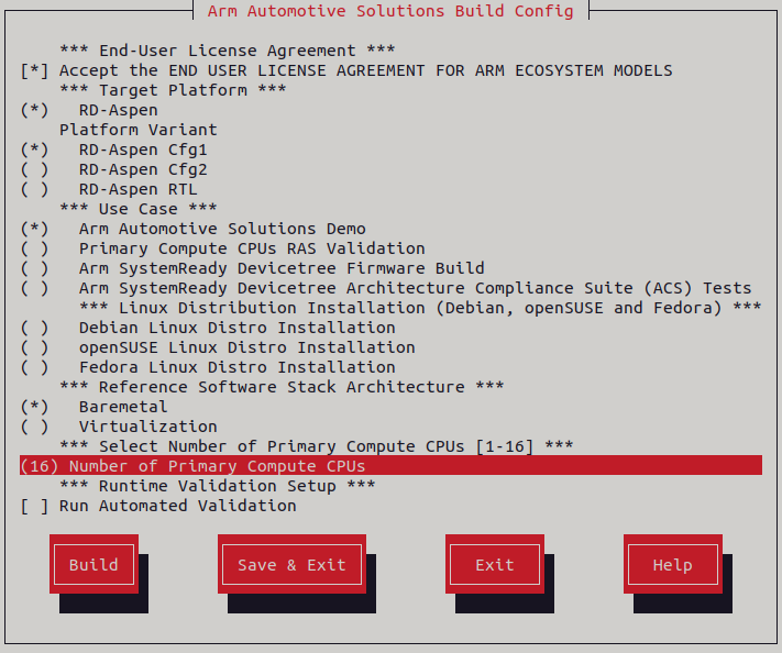

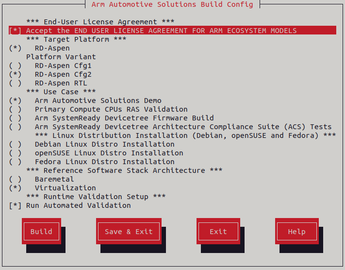

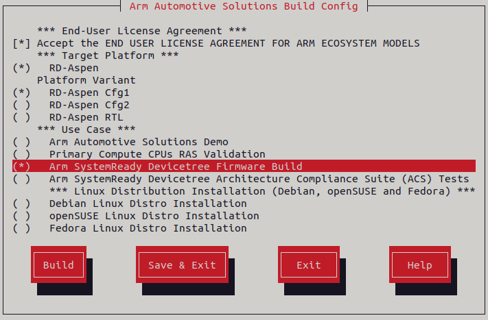

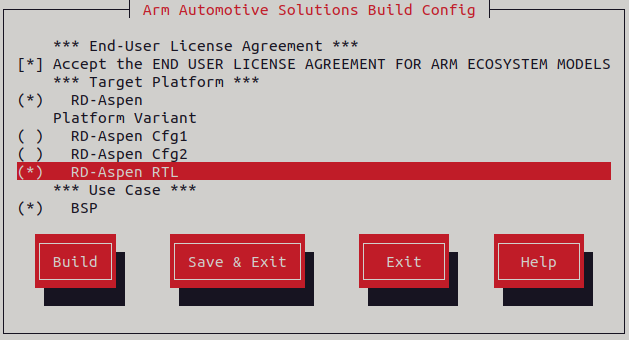

Run the following to open the configuration menu:
kas menu sw-ref-stack/Kconfig
To build and run any image for an Arm FVP the user has to accept its EULA by selecting the corresponding configuration option in the build setup and pressing spacebar.
The default number of Primary Compute CPUs is 4. The user can change this by selecting a value between 1 and 16 from the Number of Primary Compute CPUs option. And also the default Platform variant is RD-Aspen CFG1. The user can change this to RD-Aspen CFG2 by selecting the Platform Variant option.
Arm Auto Solutions Build Configuration Menu
Fig. 3 Arm Auto Solutions Build Configuration Menu
To start the build, press the right arrow key, select the Build option and press enter. Subsequent builds with the same configuration can be started by running:

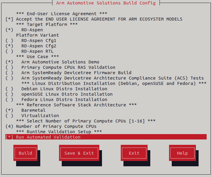

See the following instructions for building images for both Baremetal and Virtualization architectures.

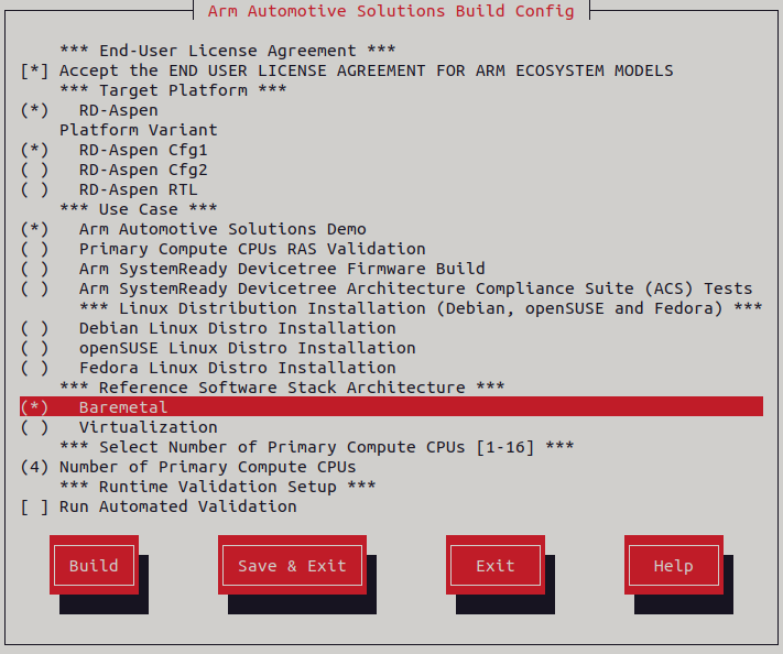

Build baremetal architecture
To run the configuration menu:
To build a Baremetal Architecture image:
  1. Select Use Case > Arm Automotive Solutions Demo.
  2. Select Reference Software Stack Architecture > Baremetal.
  3. Select Build.
To build a Virtualization Architecture image:
  2. Select Reference Software Stack Architecture > Virtualization.
  3. Select Build.

Run the configuration menu:
  1. Select Platform Variant > RD-Aspen CFG1 or RD-Aspen CFG2
  2. Select Use Case > Arm Automotive Solutions Demo.
  3. Select Build.
After the build process is complete, to start the FVP and run the software reference stack:
kas shell -c "../layers/meta-arm/scripts/runfvp -t tmux --verbose"
Ensure that the tmux window titled terminal_ns_uart0 is selected. If not, press Ctrl-b w from the tmux session, navigate to the tmux window titled terminal_ns_uart0 followed by pressing the Enter key.
Wait for the system to boot and for the Linux prompt to appear.

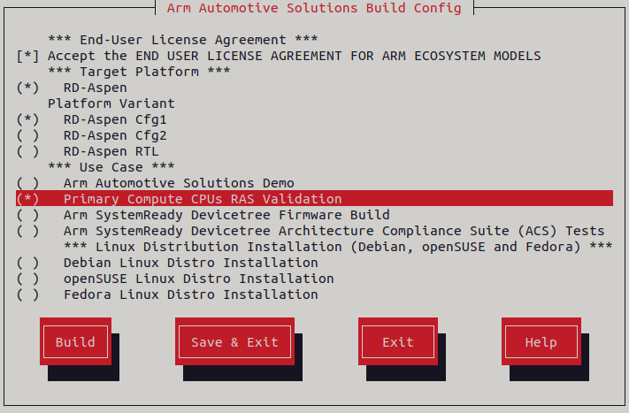

To build the CPU cores RAS validation image:
  2. Select Use Case > Primary Compute CPUs RAS Validation
  3. Select Build.
Arm Auto Solutions Build Configuration Menu - Primary Compute CPUs RAS Validation
Fig. 4 Arm Auto Solutions Build Configuration Menu - Primary Compute CPUs RAS Validation

Build
Run the following command to open the configuration menu:
Enable Mission-based power profile demo in Arm Automotive Solutions Demo
Fig. 5 Enable Mission-based power profile demo in Arm Automotive Solutions Demo
  1. Select Target Platform > RD-Aspen
  2. Select Platform Variant > RD-Aspen Cfg1 or RD-Aspen Cfg2
  3. Select Use Case > Arm Automotive Solutions Demo
  4. Select Reference Software Stack Architecture > Baremetal
  5. Set Number of Primary Compute CPUs to 16
  6. Select Build and press enter.
  3. Select Build.

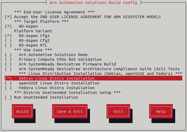

To build the Arm SystemReady Devicetree Linux distros installation tests:
  1. Select Debian Linux Distro Installation under Linux Distribution Installation (Debian, openSUSE and Fedora) from the Use Case menu.
  2. Select Distros Unattended Installation Setup > Run Unattended Installation.
  3. Select Build.
Arm Auto Solutions Build Configuration Menu - Debian Linux Distro Installation
Fig. 6 Arm Auto Solutions Build Configuration Menu - Debian Linux Distro Installation

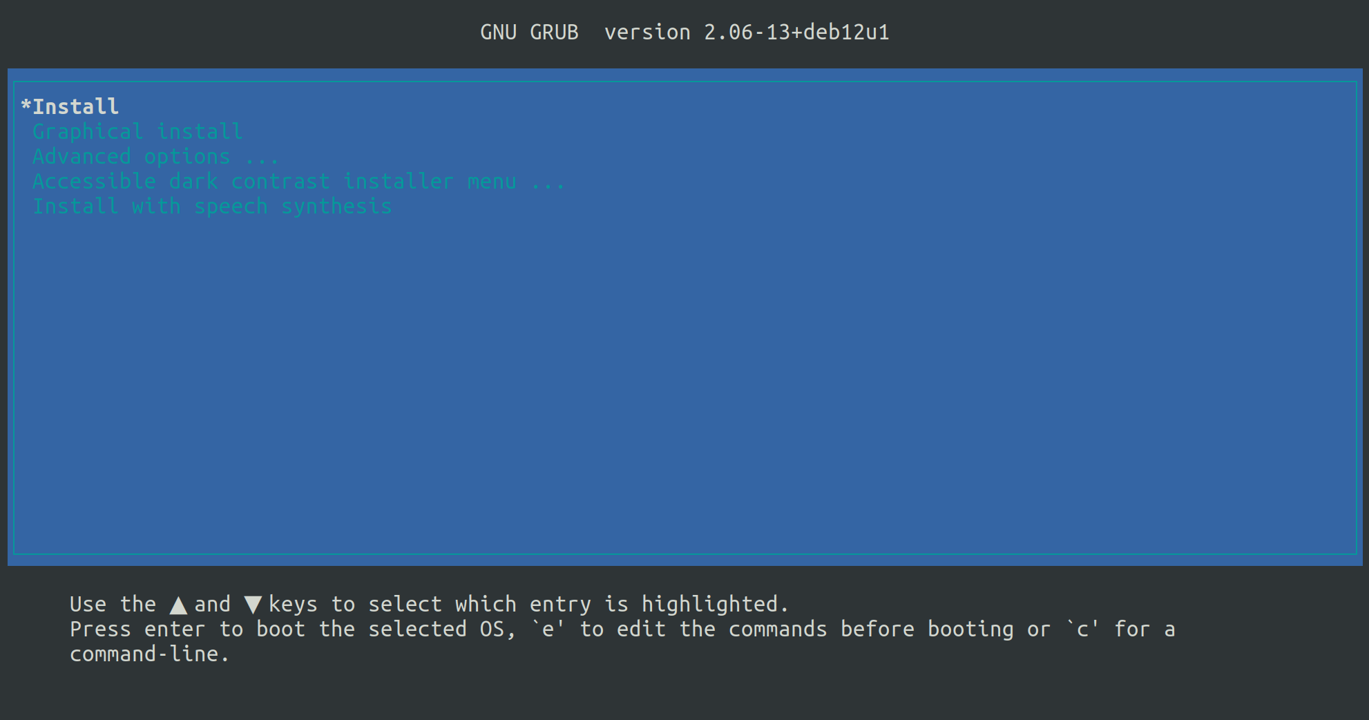

Run the following command to start the installation:
The whole process of installing Debian will probably take about 5 hours. The installation process begins when you see the following:
Grub Install Options Menu - Debian Linux Distro Installation
Fig. 8 Grub Install Options Menu - Debian Linux Distro Installation
Select Install to start the installation process.

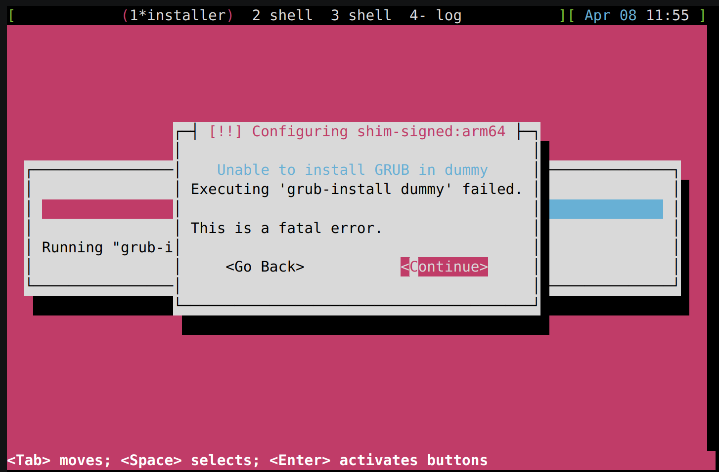

The following is the problem that has been encountered during the Debian installation process and how to solve it:

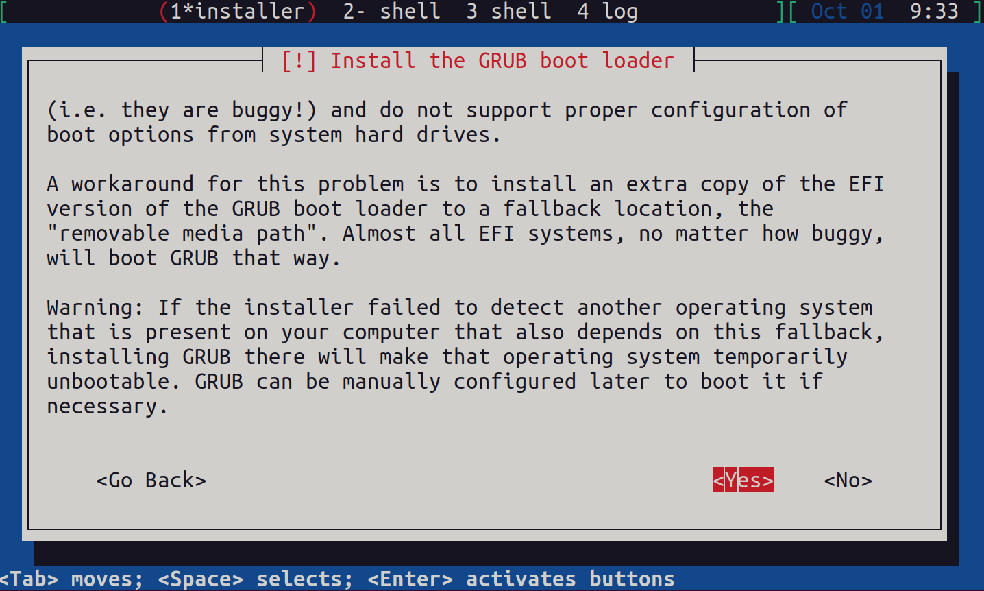

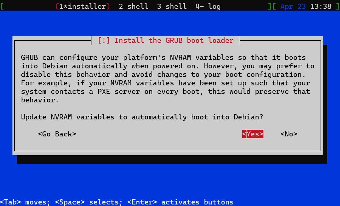

  • Install the GRUB boot loader
    When the installation reaches the Install the GRUB boot loader phase, choose Yes.
    Grub Installation Prompt - Debian Linux Distro Installation
    Fig. 9 Grub Installation Prompt - Debian Linux Distro Installation
Select Yes in the Update NVRAM variables to boot automatically into Debian and continue.
Install the GRUB boot loader - Debian Linux Distro Installation
Fig. 10 Install the GRUB boot loader - Debian Linux Distro Installation
Expect an error Unable to install GRUB in dummy. This is because on an EBBR platform, UEFI SetVariable() is not required at runtime (however, it is required at boot time).
Grub Installation Failure Prompt - Debian Linux Distro Installation
Fig. 11 Grub Installation Failure Prompt - Debian Linux Distro Installation

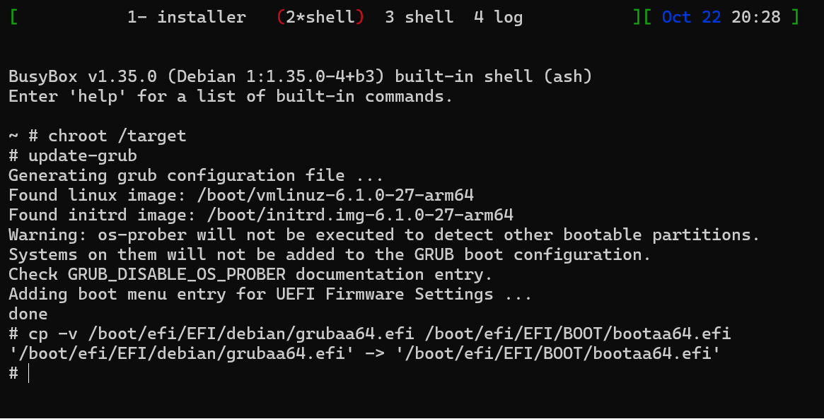

One workaround we have is to “execute a shell” when the GRUB install phase throws the above error. To execute a shell, press Ctrl-a n to switch the debug shell, and run the following commands:
chroot /target
update-grub
cp -v /boot/efi/EFI/debian/grubaa64.efi /boot/efi/EFI/BOOT/bootaa64.efi
A snapshot is as below:
Grub Workaround Console Output - Debian Linux Distro Installation
Fig. 12 Grub Workaround Console Output - Debian Linux Distro Installation
After doing the above GRUB workaround, press Ctrl-a p to go back to the installer again. Select Continue on the GRUB failure screen.

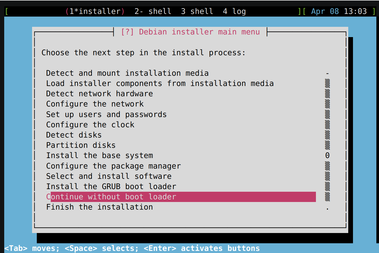

Select Continue without boot loader in the Debian installer main menu and continue.
Debian Installer Main Menu - Debian Linux Distro Installation
Fig. 14 Debian Installer Main Menu - Debian Linux Distro Installation

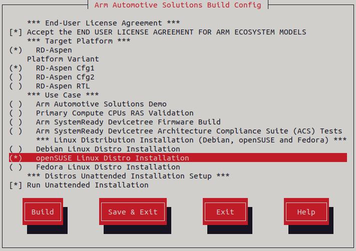

  1. Select Use Case > Linux Distribution Installation (Debian, openSUSE and Fedora) > openSUSE Linux Distro Installation.
  3. Select Build.
Arm Auto Solutions Build Configuration Menu - openSUSE Linux Distro Installation
Fig. 15 Arm Auto Solutions Build Configuration Menu - openSUSE Linux Distro Installation

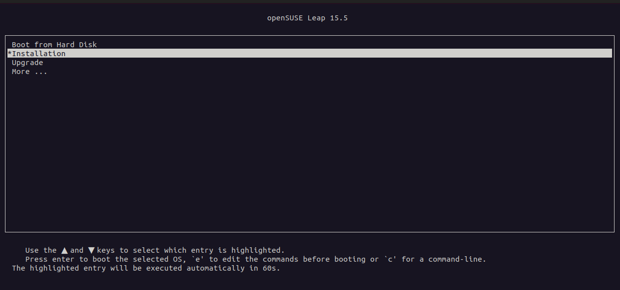

The whole process of installing openSUSE will take several hours. The install process begins when you see the following:
Leap Install Options Menu - openSUSE Linux Distro Installation
Fig. 17 Leap Install Options Menu - openSUSE Linux Distro Installation

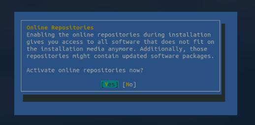

Select No when you get to the Online Repositories screen.
Online Repositories Options Menu - openSUSE Linux Distro Installation
Fig. 18 Online Repositories Options Menu - openSUSE Linux Distro Installation
Select Installation to start the installation process.

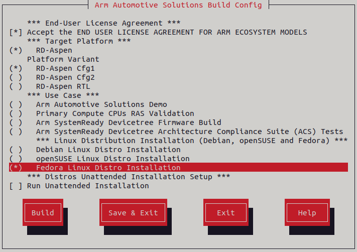

  1. Select Use Case > Linux Distribution Installation (Debian, openSUSE and Fedora) > Fedora Linux Distro Installation.
  3. Select Build.
Arm Auto Solutions Build Configuration Menu - Fedora Linux Distro Installation
Fig. 20 Arm Auto Solutions Build Configuration Menu - Fedora Linux Distro Installation
Fig. 21 Arm Auto Solutions Build Configuration Menu - Fedora Linux Distro Installation

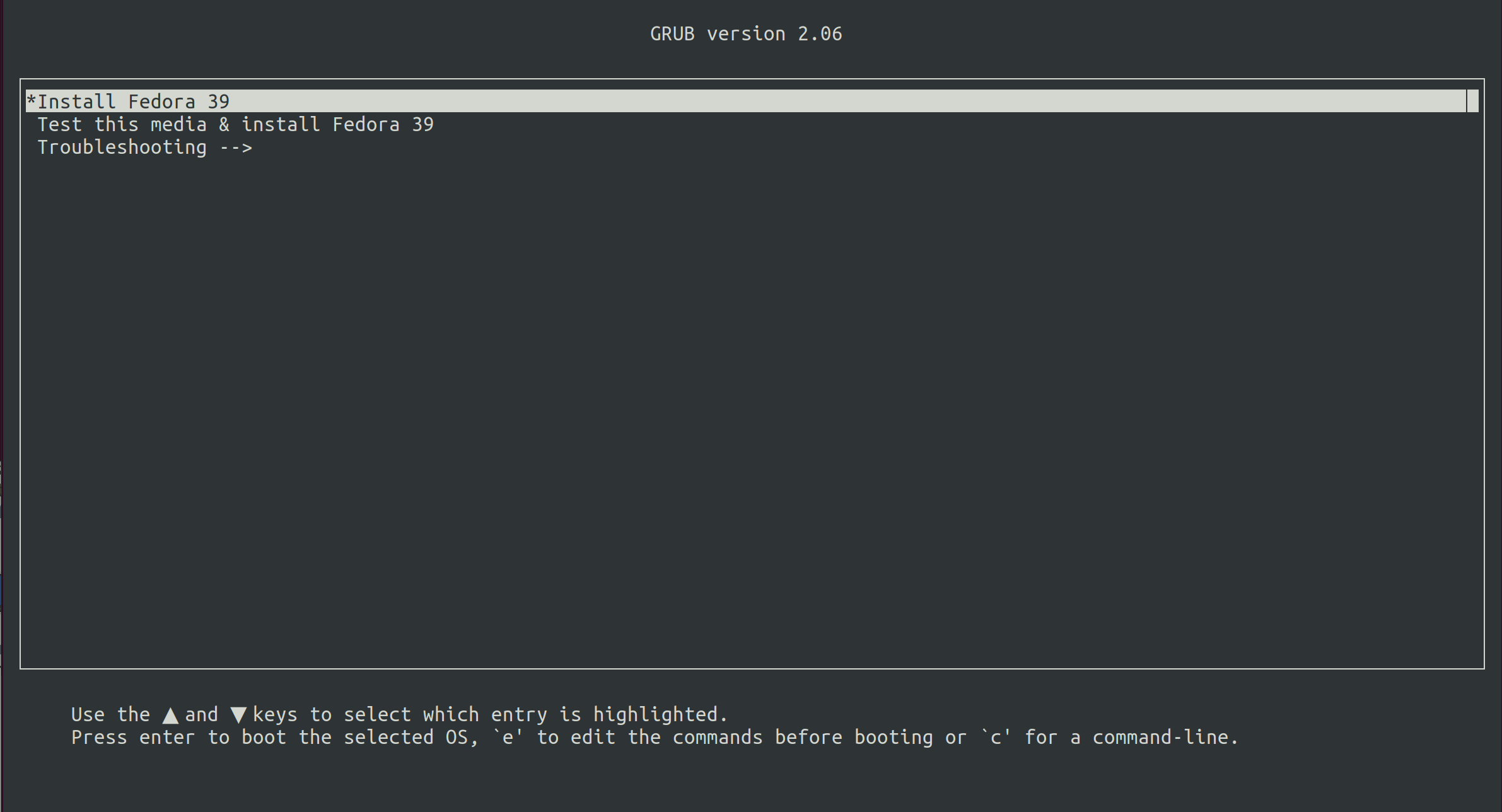

The whole process of installing Fedora will probably take about 24 hours. The installation process begins when you see the following:
Grub Install Options Menu - Fedora Linux Distro Installation
Fig. 22 Grub Install Options Menu - Fedora Linux Distro Installation
Select Install Fedora 39 to start the installation process.

    X or window manager startup failed, falling back to text mode.
    X was unable to start on your machine. Would you like to start VNC to connect to
    this computer from another computer and perform a graphical installation or
    continue with a text mode installation?
    1) Start VNC
    2) Use text mode
    Please make a selection from the above ['c' to continue, 'h' to help, 'q' to
    quit, 'r' to refresh]: 2
  3. When reaching the installation menu, you will see several items marked as ! which shows that the item needs to be configured before proceeding.
    Installation
    1) [x] Language settings                 2) [x] Time settings
           (English (United States))                (America/Chicago timezone)
    3) [!] Installation source               4) [!] Software selection
           (Setting up installation                 (Processing...)
           source...)
    5) [!] Installation Destination          6) [x] Network configuration
           (Processing...)                          (Connected: eth0)
    7) [!] Root password                     8) [!] User creation
           (Root account is disabled)               (No user will be created)
    Please make a selection from the above ['b' to begin installation, 'h' to help,
    'q' to quit, 'r' to refresh]:
    For 3) [!] Installation source, enter 3, then 1 to select CD/DVD.
    Installation source
    Choose an installation source type.
    1) CD/DVD
    2) local ISO file
    3) Network
    quit, 'r' to refresh]: 1
    For 4) [!] Software selection, enter 4, then c to continue.
    For 5) [!] Installation Destination, enter 5, then c to select the default options.
    For 6) [!] Network configuration, it will automatically change to x.
    For 7) [!] Root password, follow the prompts to enter the password and confirm.
    After entering root password, 8) [ ] User creation becomes optional and can be skipped.
    The final configuration will appear as follows:
    Installation
    3) [x] Installation source               4) [x] Software selection
           (Local media)                            (Fedora Server Edition)
    5) [x] Installation Destination          6) [x] Network configuration
           (Automatic partitioning                  (Connected: eth0)
           selected)
    7) [x] Root password                     8) [ ] User creation
           (Root password is set)                   (No user will be created)
    Now enter b to start the installation.
  4. The installer is expected to stay at Configuring kernel-core.aarch64 for several hours. The installer will then verify the installed packages and continue to install the boot loader.
  5. The following error is expected while installing the boot loader. Ignore the error by responding yes and continue.
    Installing boot loader
    Question
    The following error occurred while installing the boot loader. The system will
    not be bootable. Would you like to ignore this and continue with installation?
    Failed to set new efi boot target. This is most likely a kernel or firmware bug.
    Please respond 'yes' or 'no': yes

Arm Auto Solutions Build Configuration Menu - Arm SystemReady Devicetree Firmware Build
Fig. 23 Arm Auto Solutions Build Configuration Menu - Arm SystemReady Devicetree Firmware Build
Build
To build the Arm SystemReady Devicetree firmware image:
  1. Select Use Case > Arm SystemReady Devicetree Firmware Build.
  2. Select Build.
The firmware images listed below can be found in the directory build/tmp_systemready/deploy/images/fvp-rd-aspen/:
To build and run the Arm SystemReady Devicetree ACS tests:
  1. Select Use Case > Arm SystemReady Devicetree Validation > Arm SystemReady Devicetree Architecture Compliance Suite (ACS) Tests.
  2. Select Build.
Arm Auto Solutions Run Automated Validation Menu
Fig. 24 Arm Auto Solutions Run Automated Validation Menu
To start Automated Validation
  1. Select Arm Automotive Solutions Demo
  2. Select RD-Aspen CFG2
  3. Select Baremetal
  4. Select Run Automated Validation
  5. Select Build option and press enter.
  3. Select Virtualization
RESULTS:
RESULTS - test_10_linuxboot.LinuxBootTest.test_linux_boot: PASSED (329.20s)
RESULTS - test_10_linuxlogin.LinuxLoginTest.test_linux_login: PASSED (167.06s)
RESULTS - test_10_ping.ArmAutoSolutionsPingTest.test_ping: PASSED (0.00s)
RESULTS - test_10_safety_island.SafetyIslandTestBase.test_cluster1: PASSED (0.00s)
RESULTS - test_10_ssh.ArmAutoSolutionsSSHTest.test_ssh: PASSED (1.62s)
RESULTS - test_40_virtualization.FvpDevicesTestDomU1.test_cpu_hotplug: PASSED (83.82s)
RESULTS - test_40_virtualization.FvpDevicesTestDomU1.test_networking: PASSED (37.25s)
RESULTS - test_40_virtualization.FvpDevicesTestDomU2.test_cpu_hotplug: PASSED (27.93s)
RESULTS - test_40_virtualization.FvpDevicesTestDomU2.test_networking: PASSED (41.70s)
RESULTS - test_40_virtualization.PtestRunnerDom0Test.test_ptestrunner: PASSED (346.60s)
RESULTS - test_10_safetydiagnostics_ssu_fmu.SafetyDiagnosticsTestSSUFMU.test_safety_island_fmu: PASSED (5.32s)
RESULTS - test_10_safetydiagnostics_ssu_fmu.SafetyDiagnosticsTestSSUFMU.test_safety_island_ssu: PASSED (1.55s)
RESULTS - test_40_virtualization.FvpDevicesTestDomU1.test_rtc: SKIPPED (0.00s)
RESULTS - test_40_virtualization.FvpDevicesTestDomU1.test_virtiorng: SKIPPED (0.00s)
RESULTS - test_40_virtualization.FvpDevicesTestDomU1.test_watchdog: SKIPPED (0.00s)
RESULTS - test_40_virtualization.FvpDevicesTestDomU2.test_rtc: SKIPPED (0.00s)
RESULTS - test_40_virtualization.FvpDevicesTestDomU2.test_virtiorng: SKIPPED (0.00s)
RESULTS - test_40_virtualization.FvpDevicesTestDomU2.test_watchdog: SKIPPED (0.00s)
SUMMARY:
virtualization-image () - Ran 18 tests in 1081.765s
virtualization-image - OK - All required tests passed (successes=12, skipped=6, failures=0, errors=0)
  1. Select Platform Variant > RD-Aspen RTL
  2. Select Build.
Arm Auto Solutions Build Configuration Menu - RTL Build
Fig. 26 Arm Auto Solutions Build Configuration Menu - RTL Build
