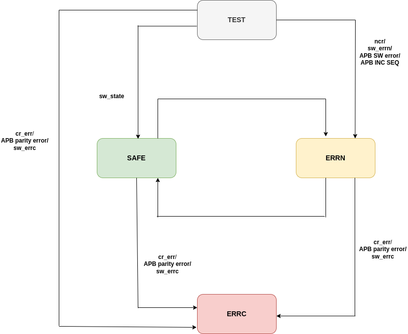

Finite State Machine (FSM)
The SSU implements a state machine reflecting the current safety state of the Safety Island, which shall be one of the following four:
  • TEST: Under testing
    • Meaning the Safety Island is undergoing LBIST or software-based testing during boot.
    • Reachable only when the SSU is reset.
  • SAFE: Safe operation
    • Meaning the Safety Island is running without any active errors.
    • Reachable only from TEST or ERRN states, by a software-programmed event.
  • ERRN: Non-Critical error
    • Meaning the Safety Island has encountered a Non-Critical error.
    • Reachable only from TEST or SAFE states, when either a Non-Critical error is detected, or by a software-programmed event.
  • ERRC: Critical error
    • Meaning the Safety Island has encountered a Critical error.
    • Reachable only from TEST, SAFE or ERRN states, when either a Critical error is detected, or by a software-programmed event.
The diagram below shows SSU FSM state diagram.
SSU FSM
Fig. 36 SSU FSM
