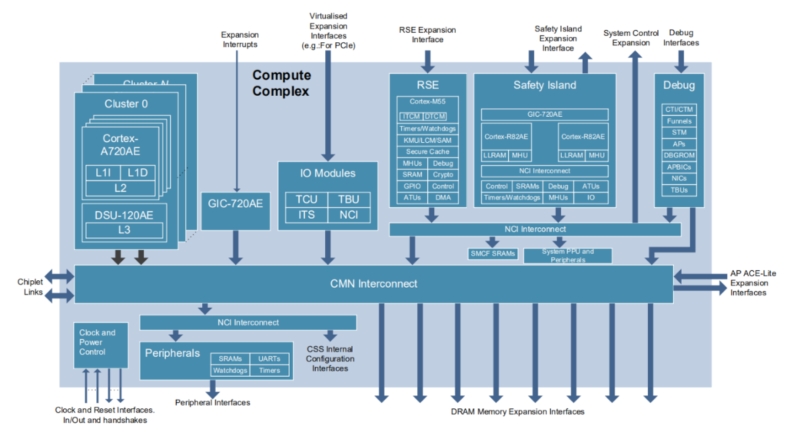

CSS-Aspen consists of the following main components:
System Block Diagram
Fig. 44 System Block Diagram

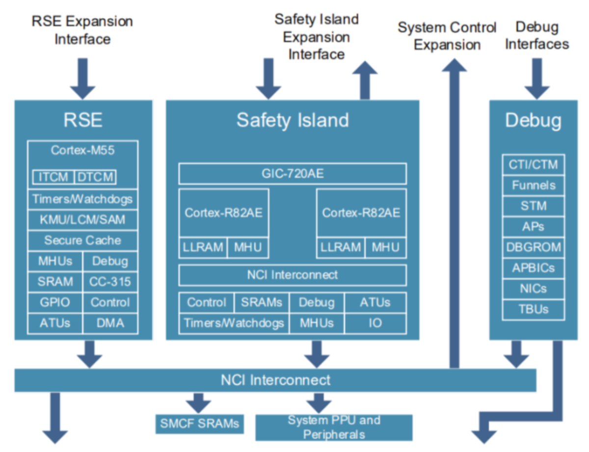

System Management Block
The System Management Block (SMB) consists of the RSE Block, the Safety Island Block and the System Management Domain, as well as expansion interfaces for system management functions including SCMI services.
Fig. 45 System Management Block
