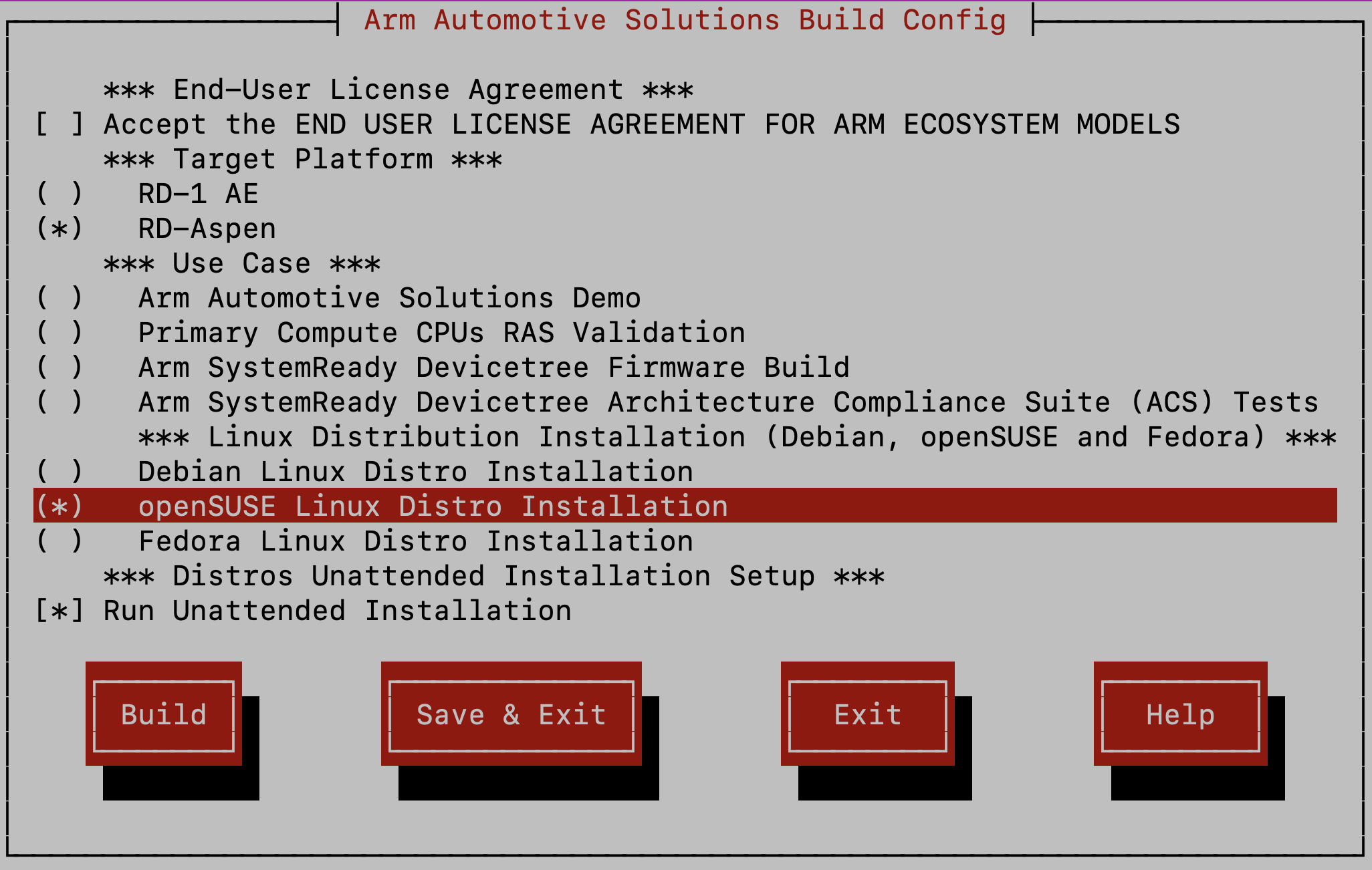

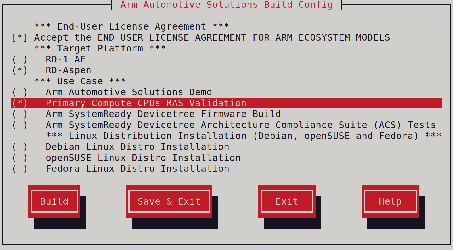

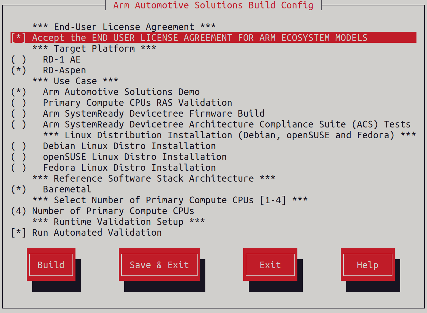

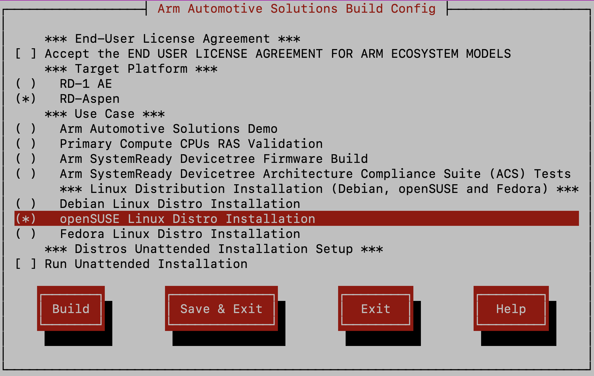

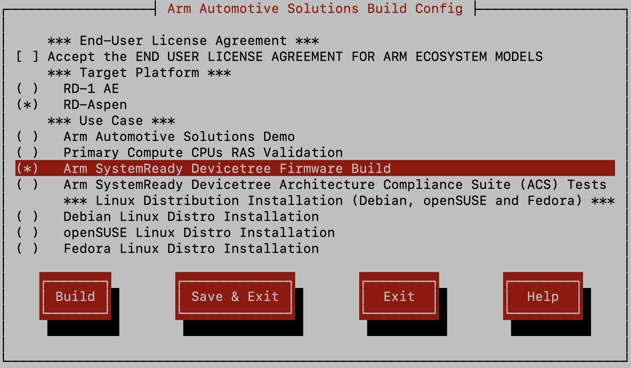

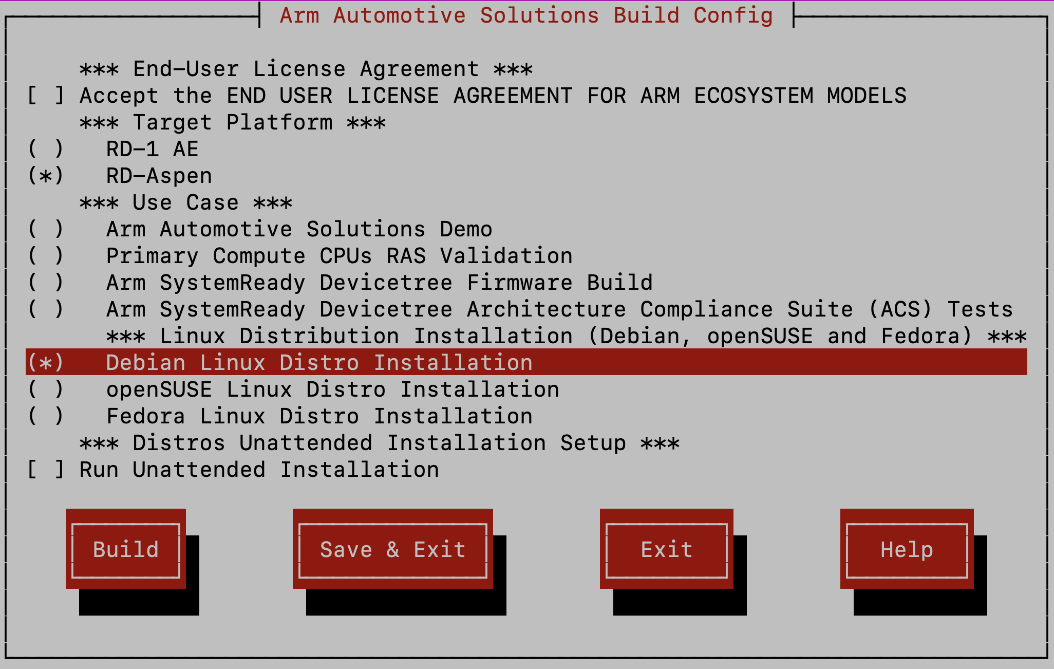

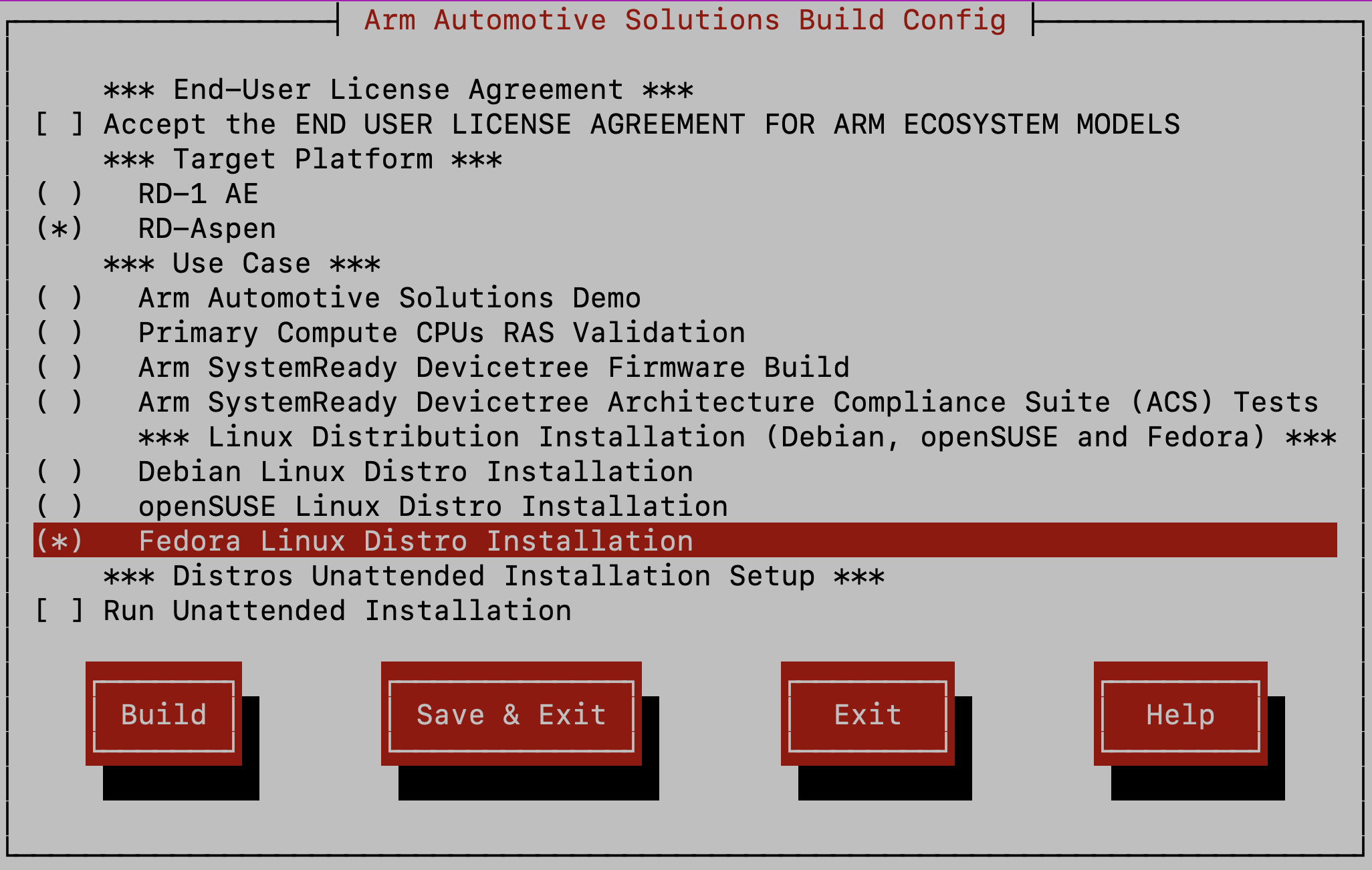

Run the following to open the configuration menu:
kas menu sw-ref-stack/Kconfig
To build and run any image for an Arm FVP the user has to accept its EULA by selecting the corresponding configuration option in the build setup and pressing spacebar.
The default number of Primary Compute CPUs is 4. The user can change this
by selecting a value between 1 and 4 from the
Number of Primary Compute CPUs option.
To start the build, press the right arrow key, select the Build option and
press enter. Subsequent builds with the same configuration can be started by
To start Automated Validation, select Run Automated Validation option from
Runtime Validation Setup, select the Build option and press enter.

To run the configuration menu:
To build the CPU cores RAS validation image:
Select
Use Case>Primary Compute CPUs RAS ValidationSelect
Build.
After the build process is complete, to start the FVP and run the test:
kas shell -c "../layers/meta-arm/scripts/runfvp -t tmux --verbose"
To build the Arm SystemReady Devicetree-aligned firmware image:
Select
Use Case>Arm SystemReady Devicetree Firmware Build.Select
Build.
The firmware images listed below can be found in the directory
To build the Arm SystemReady Devicetree Linux distros installation tests:
Select
Debian Linux Distro InstallationunderLinux Distribution Installation (Debian, openSUSE and Fedora)from theUse-Casemenu.Select
Build.
A similar output to the following indicates when the installation is finished, which will take around 3 hours:
Select
Use Case>Linux Distribution Installation (Debian, openSUSE and Fedora)>Debian Linux Distro Installation.Select
Build.

Distro installation media preparation
The firmware flash images need to be recreated with the following command:
kas shell -c "bitbake firmware-fvp-rd-aspen -C deploy"
To build the Arm SystemReady IR Linux distros installation tests:
Select
Use Case>Linux Distribution Installation (Debian, openSUSE and Fedora)>openSUSE Linux Distro Installation.Unselect
Distros Unattended Installation Setup>Run Unattended Installation.Select
Build.

Distro installation
Select
Use Case>Linux Distribution Installation (Debian, openSUSE and Fedora)>Fedora Linux Distro Installation.Select
Build.
Select
Use Case>Linux Distribution Installation (Debian, openSUSE and Fedora)>Fedora Linux Distro Installation.Unselect
Build.
