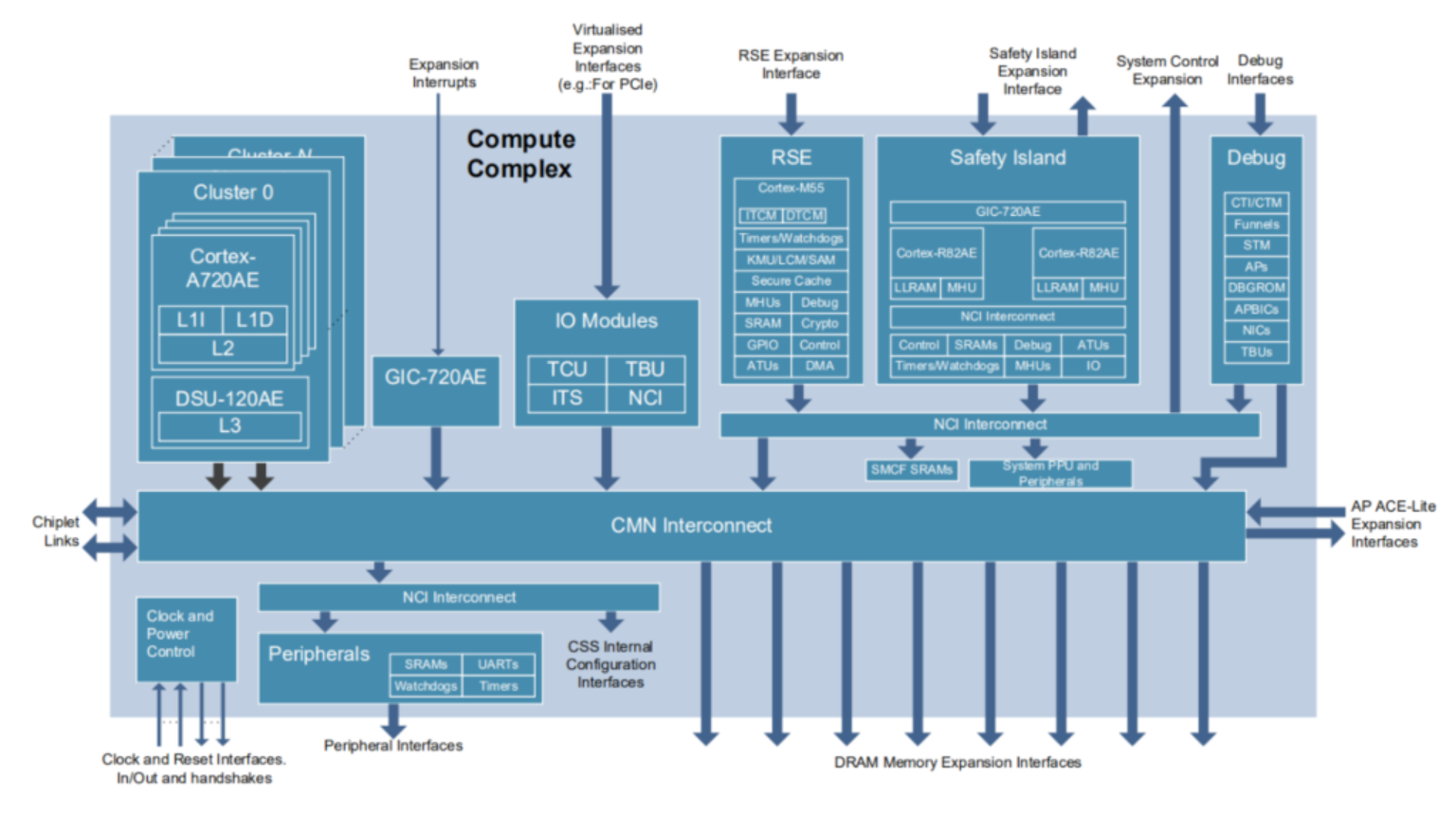

CSS-Aspen consists of the following main components:
Primary Compute
The Primary Compute consists of four processor clusters to run a rich OS such as Linux. Each processor cluster includes four Cortex-A720AE cores and a DynamIQ Shared Unit (DSU-120AE).
The DSU-120AE with up to 32MB of L3 cache ensures core coherency, supports features such as snoop filtering, bus protection, Dual-Core Lock-Step (DCLS) and power management via Power Policy Units (PPUs). For more details, refer to DSU-120AE Technical Reference Manual.
The adjacent Interrupt Block contains a GIC-720AE interrupt controller.

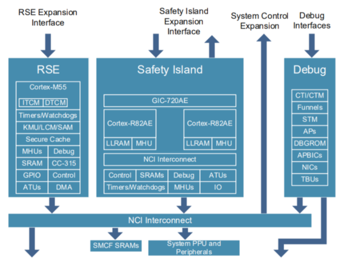

System Management Block
The System Management Block (SMB) consists of the RSE Block, the Safety Island Block and the System Management Domain, as well as expansion interfaces for system management functions including SCMI services.

Safety Island block
The Safety Island Block is a subsystem comprising of one or more Cortex-R82AE CPU clusters. The software running on the Safety Island uses the SCP-firmware framework and is responsible for power, clock and CMN control.
The number of clusters and cores depends on the chosen configuration. In the “min” configuration (the only one currently implemented), there is only one cluster with a single pair of dual lock-step cores.
The Safety Island Block contains a GIC-720AE interrupt controller.
