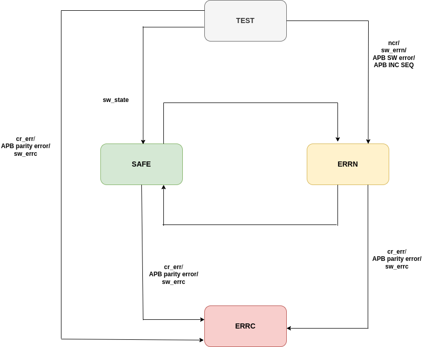

Finite State Machine (FSM)
The SSU implements a state machine reflecting the current safety state of the Safety Island, which shall be one of the following four:
- TEST: Under testing
- Meaning the Safety Island is undergoing LBIST or software-based testing during boot.
- Reachable only when the SSU is reset.
- SAFE: Safe operation
- Meaning the Safety Island is running without any active errors.
- Reachable only from TEST or ERRN states, by a software-programmed event.
- ERRN: Non-Critical error
- Meaning the Safety Island has encountered a Non-Critical error.
- Reachable only from TEST or SAFE states, when either a Non-Critical error is detected, or by a software-programmed event.
- ERRC: Critical error
- Meaning the Safety Island has encountered a Critical error.
- Reachable only from TEST, SAFE or ERRN states, when either a Critical error is detected, or by a software-programmed event.
The diagram below shows SSU FSM state diagram.
Fig. 35 SSU FSM
